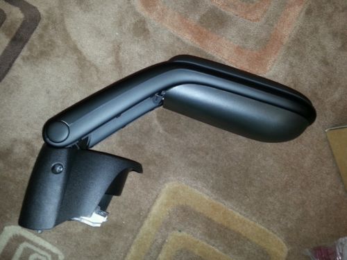

Hey Leute,
ich hab mir eine Mittelarmlehne besorgt mit allen Anbauteilen!
Eine Frage hab ich: Wo kommen die Linsenschrauben und die Spreizmuttern zum Einsatz, also wo müssen die beim Einbau hin?
Hab leider keine EBA..
Es handelt sich um die Mittelarmlehne auf dem Bild
Hi, ich hab die gleiche Mittelarmlehne nachgerüstet (also die originale, nicht die Nachrüstlösung!) und mir hat diese Anleitung aus dem englischen Mini-Forum sehr geholfen:
1. Remove the torx screw from the rear cup holder and also the front 2 cup holders (3 in total);
2. Unclip the cover/boot around the handbrake (This was the most diffcult stage in the whole process, but we found it easier to start on the sides and then work your way around);
3. Grab the long plastic cover that runs from the from the rear cupholder to the front cupholders and lightlypull the sides apart near the handbrake - you'll hear the cover clip off ever-so-lightly;
4. Feed loose handbrake cover/boot through the plastic cover, as you remove it - PLEASE NOTE: Right next to the handbrake, you'll see a thin yellow and blue wire that is connected to the underside of the long plastic cover - Use a pair of pliers to unclip the plastic clip that holds it in place (it easily snaps out);
5. Twist cover (as the cigarette lighter wire is stilled joined) parallel to the dashboard;
6. Remove the 3 torx nuts from the old base plate that is now exposed and remove it over the handbrake;
7. Insert supplied foam padding over the silver module in front of the handbrake (it is the one that carries the airbag warning on it);
8. Insert the new, longer base plate and reattach using the same 3 torx nuts that were removed in step 6;
9. Insert armrest into the base plate and secure with 3 torx screws (supplied in retro fit kit) - REMEMBER to reattach the plastic clip that holds the yellow and blue wire in place into the bottom of the base plate;
10. Reinstall the long plastic cover that runs from the front cupholders to the rear cupholder - make sure you hear it clip into place on each side of the handbrake - Reinstall the 2 torx screws that were removed in step 1 for the front cupholders;
11. Install new rear cupholder and the 1 torx screw removed in step 1;
12. Install the 2 rear covers to the base of the armrest - they go in the small gap between the base of the armrest and the base of the rear seat. The 2 covers interlock with each other in the middle and each have a torx screw that is attached on the side of each (2 torx screws in total);
13. Insert tray into armrest;
14. Clip on the rear small cover at the back of the tray;
15. Clip on the sliding lid;
16. And your done!

Hmm ja. Ich habe das Ding auch und ich glaube, mir fehlt das Ding aus Step 8. Muss mal bei BMW vorstellig werden.
Wenn jemand vorher mal Bilder hat, wie das ohne Konsole zusammengebaut aussieht, bitte mal posten. Danke...

Diese teile braucht man für die Nachrüstung, Bilder habe ich keine mehr...
1 x 51 16 9 185 223
6 x 07 12 9 906 887
4 x 07 13 1 481 910
1 x 51 16 9 194 039
1 x 51 16 9 185 112
1 x 51 16 9 185 111
2 x 07 14 6 959 889
2 x 51 16 9 305 790
3 x 51 16 2 755 697
1 x 51 47 2 754 964
5 x 07 14 6 959 826
3 x 07 13 0 657 024
#5
Ok vielen Dank, dann werde ich das am WE mal anhand meiner Teile rückwärts katalogisieren.
It's nice to be important but it's more important to be nice!
#6
Für den Umbau mit Lehne müssen der Halter unter der Mittelkonsole und ein paar Kleinteile ausgetauscht werden. Hier auf dem Bild ist gelistet was an Teilen für die Varianten verbaut ist. Pos. 2 muss gegen Pos. 3 getauscht werden.
http://www.realoem.com/bmw/showparts.do?...g=51&fg=35
Du solltest aber auf jeden Fall mal mit Deiner Fahrgestell-Nr neu suchen weil es auch verschiedene Ausrüstungsfarben gibt.

Also Einbau hat mit Ärgern wunderbar geklappt! Danke an alle Yeah!

Ah ok, dann weiß ich jetzt, was mir fehlt. Bestelle ich morgen, mache Bilder beim Einbau.

Also wenn die Abdeckung der Mittelkonsole weg ist, dann hat man den größten Ärger hinter sich!
Ich hab ewig mit der Handbremse gebraucht, bis ich den Handbremssack ausgeclipst hatte und dann muss die Handbremse halt noch durch die alte Aufnahme durch!
Mit ein bisschen Geduld klappt es wunderbar und dann ist der Rest ein Kinderspiel!
GEDULD ist das Zauberwort Yeah!
